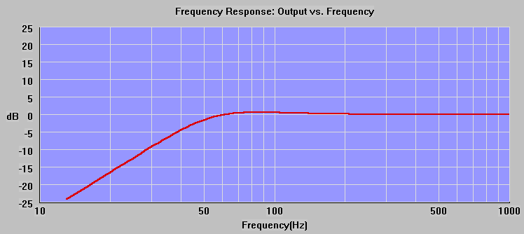

  • > Any open back cabinet is brighter sounding in both midrange and high frequency.
    This appears to contradict generally accepted principles.
    Open/closed back cabinets only affect signals below 800 Hz as per the work of respected scientists in this field. A choice of cabinet should not have an effect on the Midrange and high frequency response as per work by Thiele-Small.
    Most cabinet design software dont even bother to show Mid and high response as the Cabinet only changes how the bass responds. Here are two examples :
    High frequency response is determined by the Tweeters
    Tweeters are normally self enclosed
    You get the same High end response from a tweeter irrespective of if you mount it on a Open or a closed cabinet.
